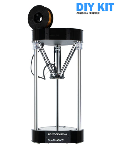

The RostockMAX v4  D.I.Y. Kit

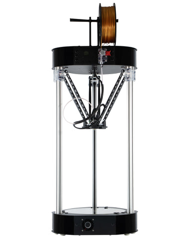

The SeeMeCNC RostockMAX series has lead the delta way since 2012 when we sold our first kits.
The RostockMAX v4 features a powerful A/C heated bed and metal enclosure.  The improved heated bed improves adhesion and performance.  Responsive power to reach higher bed temperatures in minutes. Typical heated bed response time to reach 60C temperature is approximately 4 minutes and 100C in about 8 minutes. Combined with the SE300 auto probing hotend, the RostockMAX has never been better.
The 32 bit Duet Wifi controller provides smooth, precise, and quiet motion control. The smooth motion is a combination of the 32 bit control board, 0.9 degree stepper motors, and our unique low-no maintenance Cheapskate linear motion design. The EZR Struder precisely drives filament to our SE300 probing hotend. The SE300 hotend is ready for filaments requiring temperatures up to 280C.
