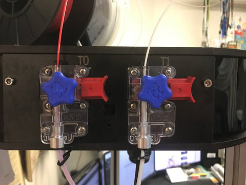

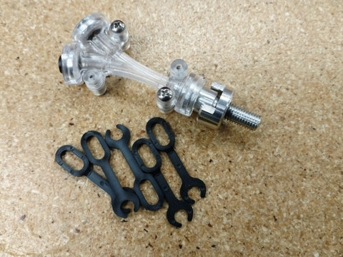

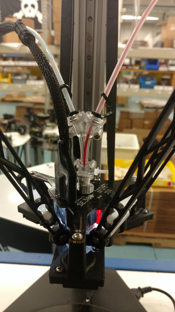

These kits come complete with everything needed to install on to your compatible SeeMeCNC 3D printer. With our Dual Filament Feed Adapters you can feed and print in 2 different materials or colors with one single nozzle.  These adapters are injection molded from clear ABS material so you can see what's happening when changing filaments for easy troubleshooting as well.
These adapters are made for use with 1.75mm filament only.  They come with 4mm PTC cartridge fittings and our PTC lanyards to prevent backlash and lock the fittings on to the PTFE tubing.

Included:
  • one EZR Struder kit
  • optional stepper motor
  • Dual Extruder mounting panel white or black for RostockMAX v3 and v3.2
  • 2mm ID X 4mm OD PTFE bowden tube
  • PTC clips for locking all PTC fittings to PTFE tubing
  • Dual Feed Adapter and assembly hardware
