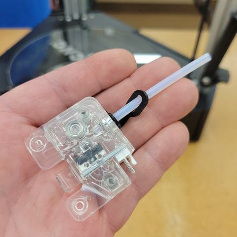

The switch easily snaps onto SeeMeCNC EZR Struders. No tools required for mounting to the EZR Struder. The snap on design allows quick installation and removal should you need to service the extruder or clear dust.
The switch is normally open (N.O.) when filament is present and closes when filament is removed. Should you decide to bypass the switch, simply unplug it.
Features a 4mm PTC bowden input fitting and partial input tube. This is very useful for hook up to a dry box.
