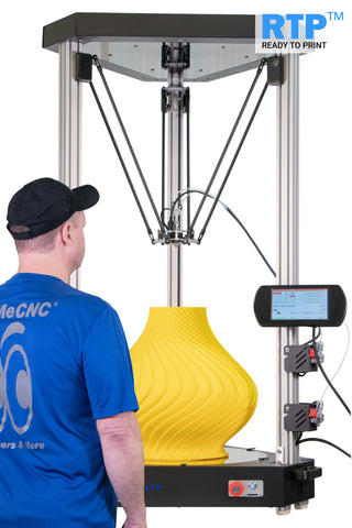

SeeMeCNC large format 3D printers will meet your business needs for commercial 3D printing through price, performance, and reliability. Large 20.5" (520mm) diameter AC powered heated bed.
The BOSSdelta™ 500 is  currently our largest desktop machine. The 500 series BOSSdelta has 1/2 meter (500mm) diameter build plate.  Model 0505 is a desktop machine with 1/2 meter tall build height.  And models 0510 and 0521 are floor models with 1 meter and 2.1 meter build heights respectively.
The  BOSSdelta™ features our eSlide™ linear motion system.  The eSlide™ linear motion solution is engineered and manufactured by SeeMeCNC.  Our linear motion design started in 2012. We designed our first high accuracy, lower cost linear motion system for the RostockMAX series 3D printers. We have years of proven performance, low maintenance, high reliability, and high accuracy, of our eSlide™ motion system.  The design has commercial-use in mind. Our unique wire cable to belt drive system provides accurate positioning of the hotend platform even on extend Z height models.
The aluminum hotend platform uses the SE300 hotend assembly.  The SE300 hotend is designed for 280C maximum operating temperature.  The SE300 hotend contains an integrated strain gauge sensor for providing reliable and accurate automatic probing and calibration.  During probing, the nozzle taps the build surface for the highest accuracy even after a nozzle change.  The carbon fiber arms rigidly connect the hotend platform to the carriage slides.  The print surface (bed) is borosilicate glass and can easily handles 100C temperatures maintained by the 800W industrial heater. The glass build plate heats from room temperature to 60C in about 4 minutes and 100+C in approximately 12 minutes.
The 7 inch touchscreen controller is removable so the printer can be operated at the print bed level.  The is useful for custom setups or making adjustments during operation without having to reach for the controls.
The BOSSdelta™ 500 features a Duet 32 bit main control board with Ethernet connection for your network.  Connect to internal networks using a standard network cable. The printer console screen will display the assigned IP address.  From a computer web browser on your network, simply enter the IP address of the printer to display the web control interface for the printer.  Optionally, it is not necessary to connect to any network. The printer can be operated by using a quality SD card 32Gb or smaller inserted into the front of the printer.
