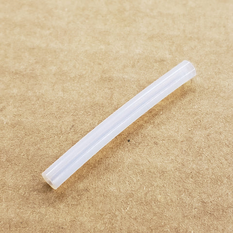

This short tube inside the hotend and is approximately 38mm long.
Details
  • One end of the inside of the tube is chamfered (beveled)
  • The inside chamfered end is the top
  • The overall length tolerance of this part is +/-1mm long
  • 2mm ID X 4mm OD
  • Quantity One Part
