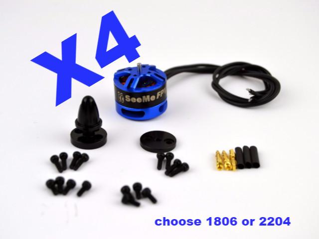

This power pack comes with 4 of our SeeMeFPV motors, 4 of our 20 amp BLHeli ESC's and 1 pair of XT60 Connectors. Everything you need to power your next FPV racing multi rotor in a quadcopter configuration. Choose from our 2204-2300kv or our 1806-2300kv motors depending on your frame and prop size.
Motor Specs -
- 200mm motor wire leads
- 2204 motors feature M3 motor mount holes - 16mm x 19mm pattern
- 1806 motors feature M2 motor mount holes - 14mm x 16mm pattern
- M2 prop adapter mounting holes - 9mm 4 hole pattern
- Comes with M2 x 5mm and M3 x 5mm hardware
- Includes 3 2mm bullet connectors
- Includes standard right hand 5mm prop adapter
ESC Specs -
- 20 Amp continuous - 30 Amp intermittent
- OPTO - (No BEC Circuit for lightweight)
- SN20 w/BLHeLi 14+ pre-flashed with DL enabled
